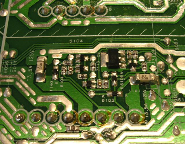

TV does not switch "on", front LED blinks 3 times (error 3).
Cure
INFO:
If TV is switched "on", there is no backlight and no sound.
CURE:
1. On the PSU, check the voltages on connector 1M95 and 1M99. See figure 1.
2. If not okay, check for a short-circuit of diodes i.e. D6105 (order code 482213031607 DIO RGP10D-E3/54).
3. Is still not okay, also check for bad solder joints on transformer 5104: resolder if necessary (see figure 2).
IRIS CODE:
Fig. 1 Connector overview.
Fig. 2  Solder joints of transformer 5104.
voila une info quand meme de chez philips
